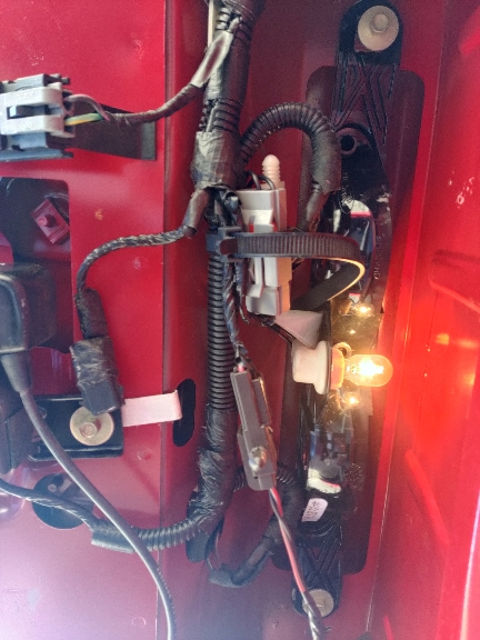

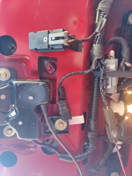

Hi guys I can't find any info on this and wondering if you guys have come across this. I see in the receipts that came with the car that the trunk light fixture was replaced at one point and there appears to be a plug-in that isn't being used back here, can probably see it in the pic? My thought is that they aren't plugged in because both aren't working. When I try to unscrew the two plastic scews on the lightbulb holder they just spin. Any help would be much appreciated.

Try rotating the white lightbulb holder on the inside of the trunk 45 degrees. Also, the two screws holding the license plate light fixtures on the outside are plastic push rivets. You must be very gentle removing them without pushing in while trying to unscrew them. If that doesn’t work, try a knife blade tip between the plastic screw and the body of the plastic rivet and gently unscrew the plastic screws.

I didn't speak up yesterday as I wasn't sure, but since no one else has = I think that harness is empty on most cars, can't remember why though to reassure myself that its true.
Do you have a volt meter? Try turning the lights on and stabbing the wires to see if you have power back there.
That worked like a charm I can't thank u enough. I stuck an exacto knife into them and then held the retainer thing from there inside and then unscrewed with the exacto knife! Found out the plastic socket is crap and the bulbs are crossed but they did turn on when I googled with them. Wonder if I can get these sockets somewhere local?
