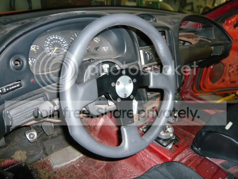

Adam (Comporange something is his username) has a setup in his road race car. I don't know of many other people who have deleted the airbag and all that.
EDIT: Because I'm bored, I found a pic:
He has a quick release and all that on it. His interior is a bit different now as he's tossed the dash but I couldnt find a pic with the steering wheel in and everything else out.
