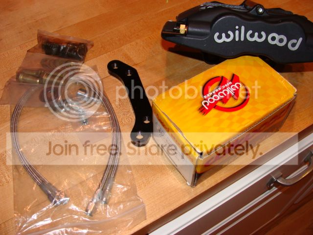

They do look correct, my kit came with:
The thread pitch is obviously important. Sounds like you have it figured out. The rev-kit came with the Wilwood Polymatrix 'B' compound pads, this would make a great street compound. Good bite when cold, little dust, and still did great when hot. But I burned them up in 3 track days, so they do wear when they get continuous use in the heat.
