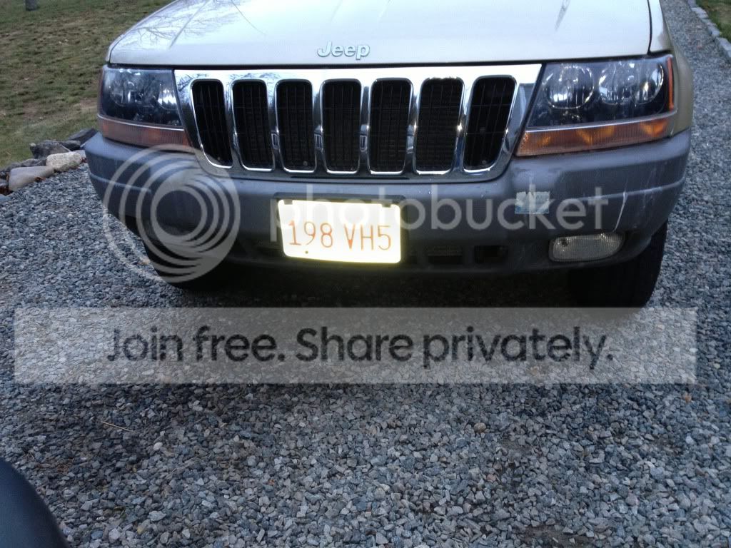

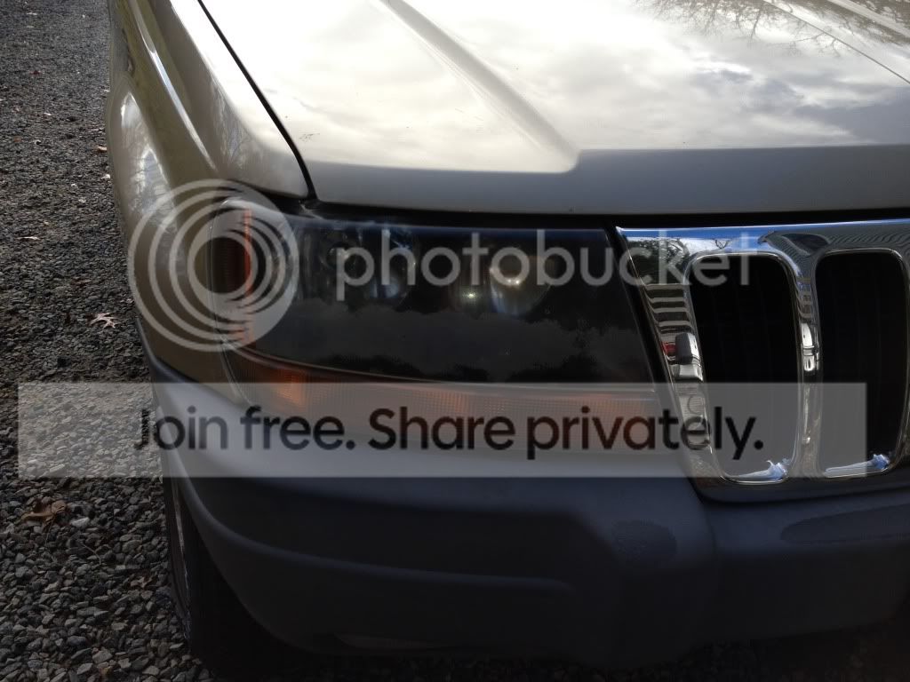

Before
After

I swear I think Cherokee's are the worst for this. It seems like everyone I see has fogged up headlights. Awesome work though guys! I love reading threads like this. Been detailing forever now but always like to read and pick up on other peoples tips and tricks. Who said you cant teach an old dog new tricks??!! LoL
Sinned83
Feb 10, 2010
4,439
56
MA
They are but not mine anymoar
