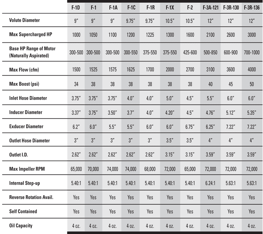

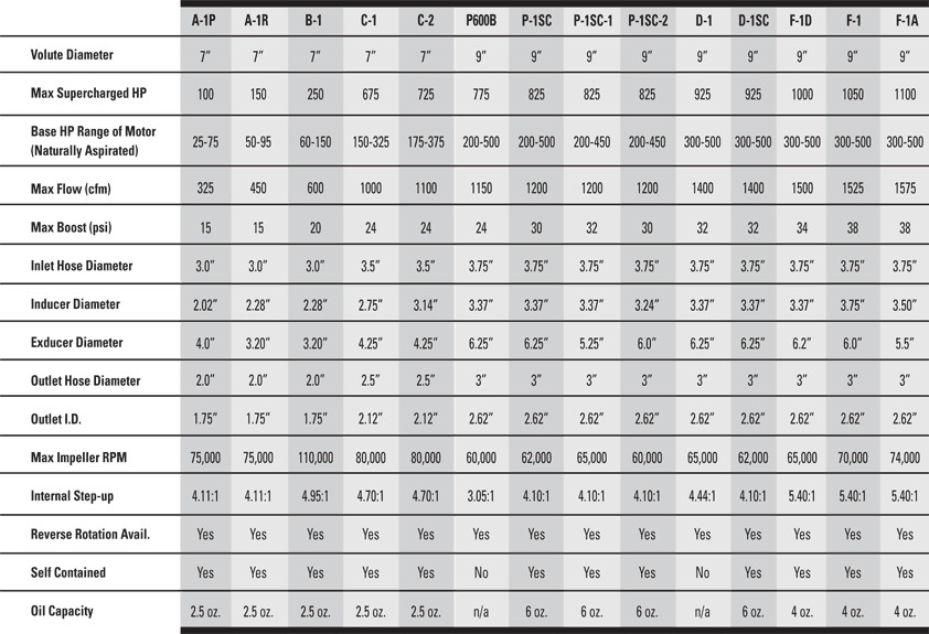

Procharger headunit Specs
auto_x5.0
May 14, 2007
3,233
These are directly off the website
The stated figures are not absolutes, and may actually be higher depending upon
the specific application.
These figures are based on stated peak airflows; actual obtainable power levels
may be higher in well prepared engines.
Engine intake charge air temperature is the most relevant thermal measure
(not SAE J1723) for supercharger installed on a vehicle, especially when
intercooled; SAE J1723 does not address the impact of engine dynamics, engine
compartment heat transfer, intercooling, or deficiencies caused by supercharger
location.
