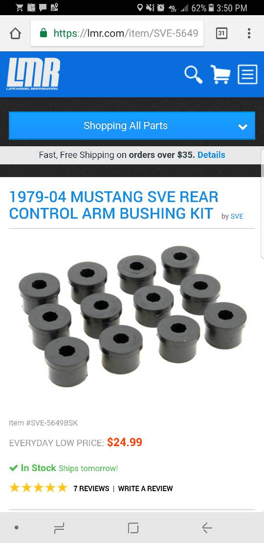

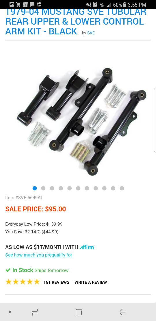

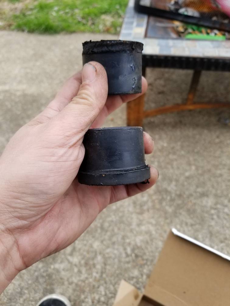

so shop says it's rear control arm bushings are out. I looked and they're falling apart. we loosened the trans mount , it's a lil better. I have sve tubular control arms so replacement bushings are out. gonna get a new kit. will keep this post up-to-date

first pic is what mine look like, second pic is replacement bushings.

The problem with those cheap control arms is that they are not built very strong. Also, having poly bushings on the both sides of the control arm will cause it to bind. Im not surprised these bushings went out, and youll probably end up replacing these things every so often until you change those control arms.
DKblue98GT
Dec 19, 2009
1,406
333
I never considered what other parts you might have. I know it's more money but I would recommend Something like MM lowers with spherical bushings on one end. Stock uppers are good and you want rubber bushings on the axle side.
