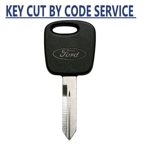

I see listings on ebay for Ford OE keys for $40. The problem is i'm not sure i trust them as really being OE. I'm trying to find key part numbers/ID numbers so i can do a little google searching and see if i can find any non-dealer sources.
For example.
Ebay link to key
I guess even if they are not OE, it doesn't matter as that's what i'm using now anyway. I just prefer a Ford-branded key.

Heck I'm surprised they have any out there. I don't know how you'd check honestly - the keys were never really made by Ford anyway, they were made by some 3rd party who stamped Ford on them. Sorry - I have no clue how you'd tell.
Can you get a Ford part #? I looked at your posts - you have a '00 right? I know there was a chance in '98 or so - at least in how you could program keys. Before that you could do it without the dealer / FORSCAN etc - you could do it in the car if you had a working 'master' key.
I just looked up the replacement key part #
H72-PT​
Searched Ebay then checked 'Ford' as the brand
Two examples
Oh i'm sure you are right.
However I think you got me on the right trail
The key you linked is a Strattec and from what i can see from the above link, they are a licensed producer. The part numbers match up. So, i just likely need to buy 2 of the keys you listed and give this a shot.
Edit: 2 on the way

These will definitely do. Exactly what I was looking for. Into it for $40 for these two keys
