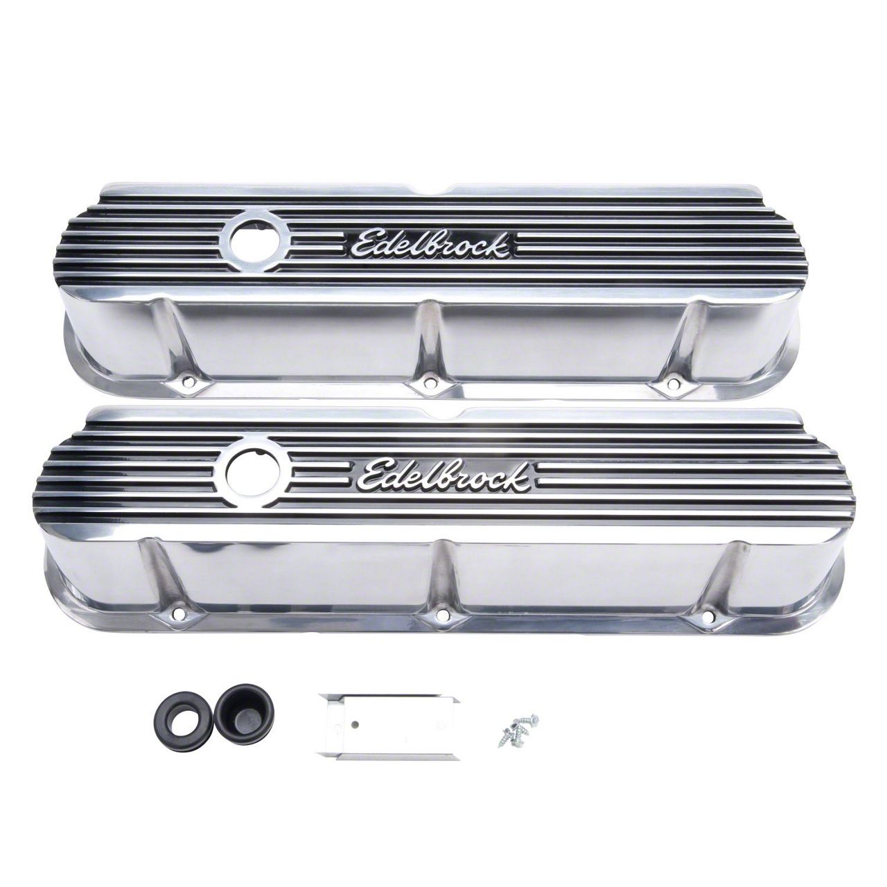

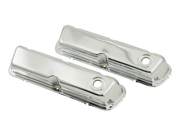

Found a few:
Likely would need a spacer
These say direct replacement so 'should' fit fine?
